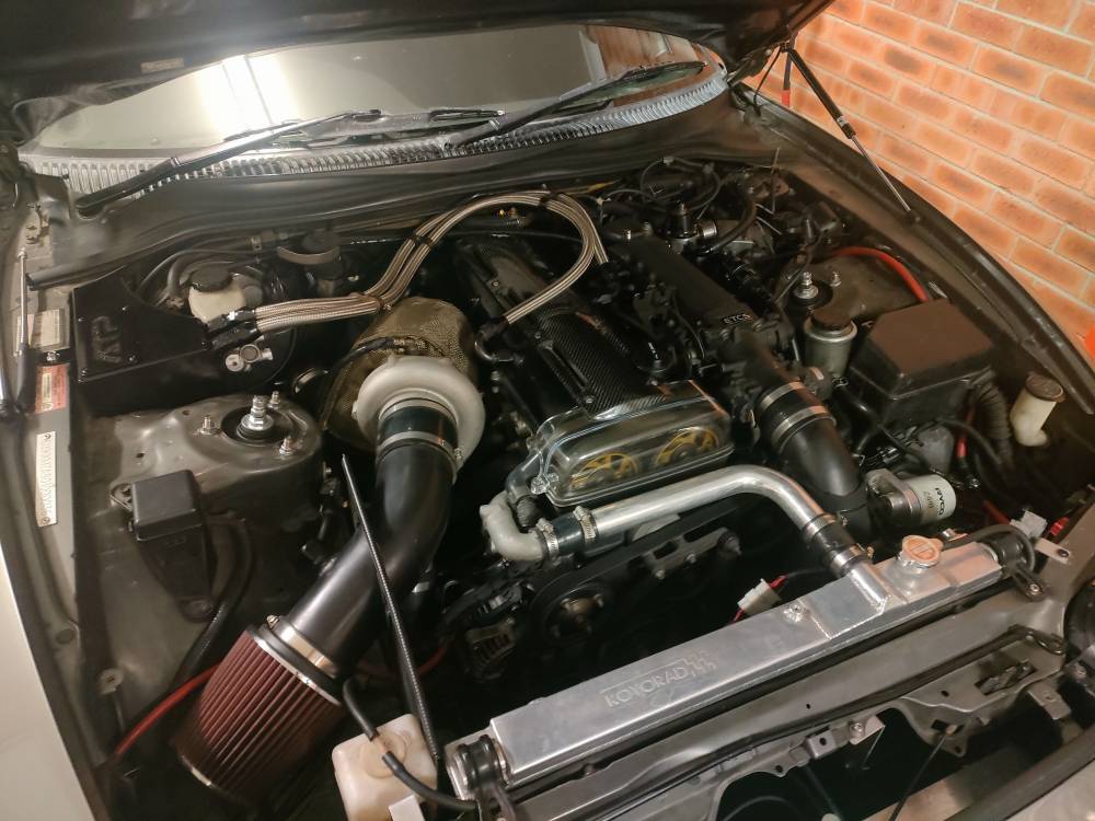

    Engine: 2jzgte stock block. 6466 gen2. 264 kelford cams, 2200cc injectors (28psi e85)
    Power (at wheels): 540rkw

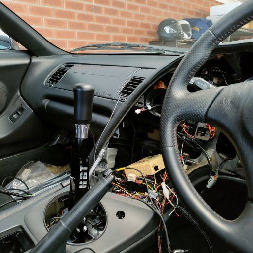

    Gearbox: HGT sequential 6 speed dogbox

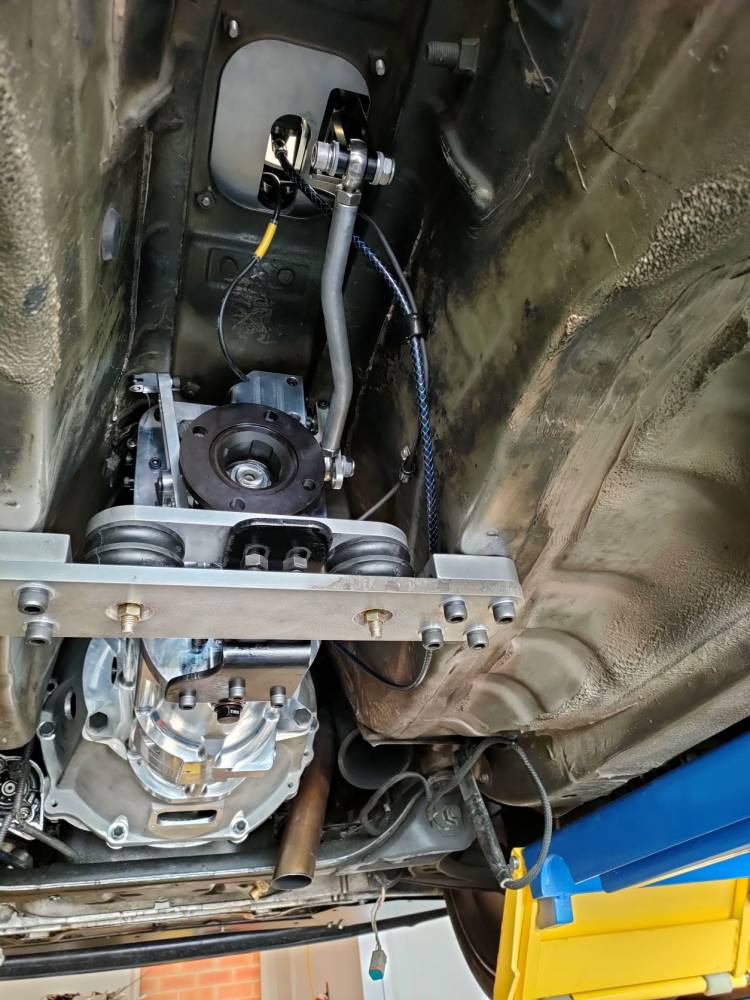

    Driven Tires: Michelin Pilot Sport 4S 305-30-19
    Differential: 3.25 ratio Grannas 8.8" diff

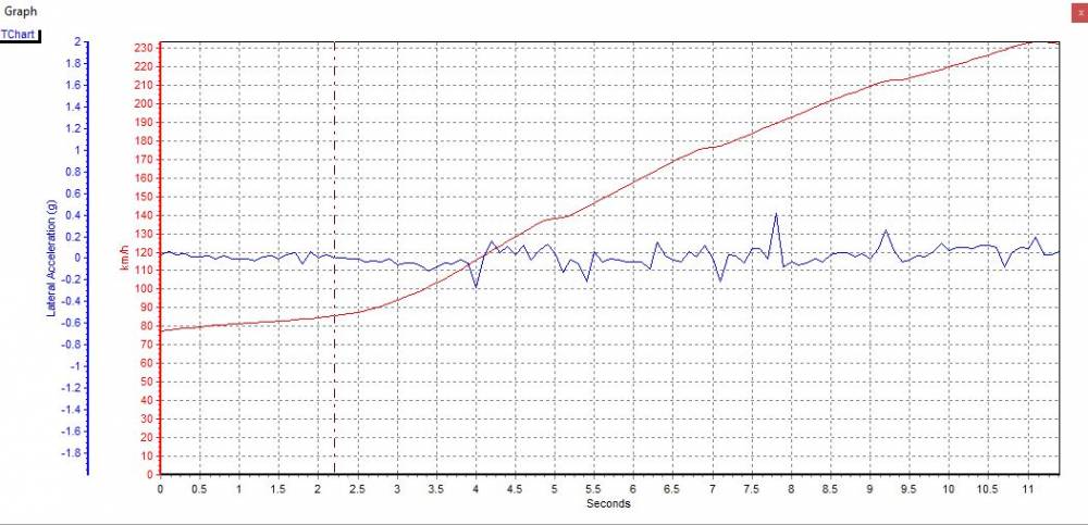

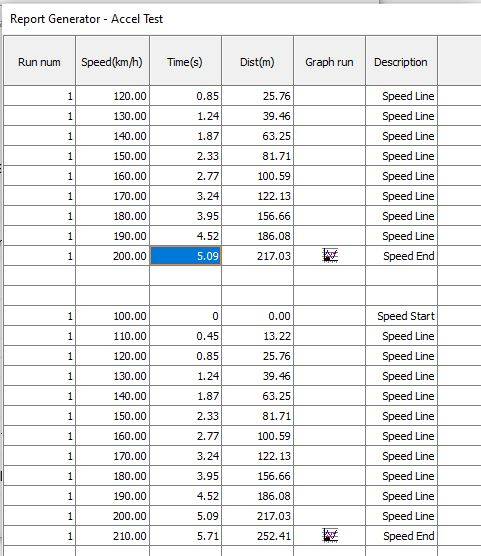

    100-200kph: 5.09s
    I now rebuilt my 2jz to have a 3.2L stroker with vvti head and a slightly larger 6870 turbo and will post 100-200kph again hopefully sometime in Q1 2025 :)
